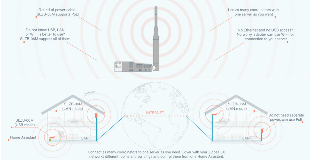

j'ai eu une réponse officielle du fabricant, ce n'est pas possible à ce jour :
Hello Bernard,
Thank you for reaching out and for providing more details.
Unfortunately, what you're trying to achieve — a single Zigbee network seamlessly bridged over Ethernet using two SLZB-06M adapters — is currently not supported. The concept shown in the schematic is a theoretical one, but in practice, there is no existing Zigbee bridge that can transparently forward Zigbee traffic over LAN between two physical adapters.
This means you would need to set up two separate Zigbee networks, each with its own coordinator (one per SLZB-06M adapter), and manage them independently. To do this with Home Assistant, you would typically run two separate instances of Zigbee2MQTT (Z2M), one for each adapter.
So yes, it's possible to connect them via LAN, but they will operate as independent networks — not as one unified mesh.
Let us know if you need help configuring this setup.
Best regards,
SMLIGHT Team
