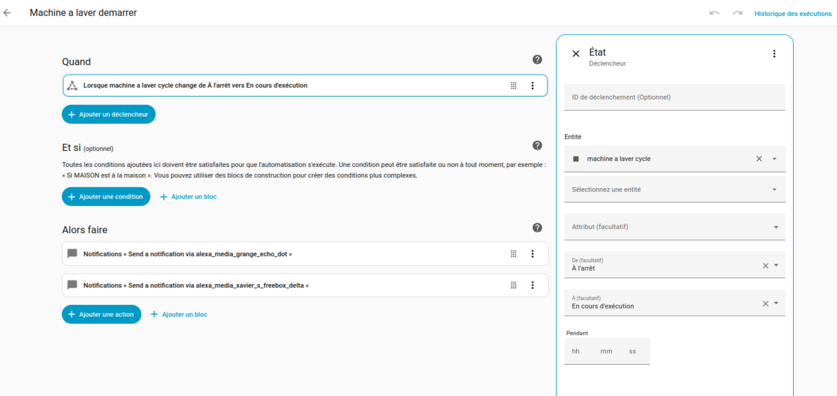

Salut @titi25520 ,
Moi J'utilise Alexa, et je suppose que le principe est similaire pour créer une automatisation.
Exemple :
alias: Machine a laver demarrer
description: ""
triggers:
  - trigger: state
    entity_id:
      - binary_sensor.machine_a_laver_cycle
    from: "off"
    to: "on"
conditions: []
actions:
  - action: notify.alexa_media_grange_echo_dot
    metadata: {}
    data:
      message: Cycle de la machine a laver demarrer !
  - action: notify.alexa_media_xavier_s_freebox_delta
    metadata: {}
    data:
mode: single
